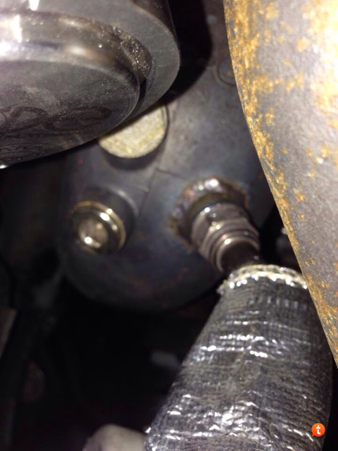

This is the solution for cpe downpipe, new welded o2 bung, but I got new custom dumptube

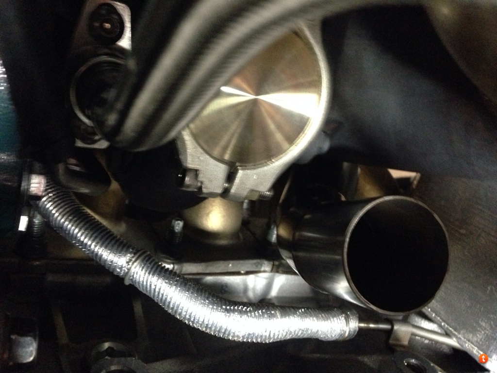

well fuck I don't have EWG anymore, but I still take a pic for you guys. Hopefully you can kinda get an idea.

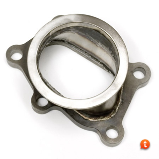

You guys have any idea about this ^^^ will it work with kozmic DP ?

Unfortunately this downpipe would have to be modified to run on a garrett turbo. Garrett turbo Vband flanges are different then a Precision, you would have to have the flange chopped off and have a new Garrett Vband flange welded back on.
The piece is very top notch quality, it was designed around running a Precision Vband inlet/outlet housing turbo on a CPe manifold.
Sent from driver seat, bro!
tapafuck....
The entire downpipe would have to be modified for that too work Iboo. This would extend the downpipe off the turbo further causing lower fitment issues with clearance etc!
Dang (( I is sad :///
Well I will get it when I go to precision turbo, of course after ZZB
So the litter flapper door thing to the far left is where the SSP dump tube would route too with the Tial-MVR WG. large amount of space between the tube and o2 sensor.

Guys,
The CP-e Downpipe does WORK with the manifold (ask me how I know).
The O2 sensor has no issues with hitting the wastegate.
It is the SSP (actually Kozmic I believe?) dumptube that interferes with the O2 location, which they obviously could not forsee.
Also, the Tial V-Band housings are a different matting surface on the discharge. A PTE V-Band discharge flange will not mate up or create a seal.
LumberJack likes this.

So my 3 inch vband downpipe will not match up with my 3 inch vband exhaust on my PTE turbo? Old downpipe was used on a garrett
interesting learn something new everyday.
860whp/677wtq
2.7 V6 Ecoboost
Mauro_Penguin (02-17-2014)
 Old 02-17-2014, 09:54 AM   #28
LumberJack's Avatar
Posts: 2,580
Rep Power: 2724
Thanks: 3,896
That's correct. You'll need to have a new flange welded on an potentially the dp modified for how the precision turbo hangs lower

The question has been asked many times and has yet to be answered, what setup for dump tube are you using (custom, new Kosmic, SSP modified, no dump tube)? I have heard that kosmic (the old SSP company) now have an EWG dump tube that fits without running into the O2 sensor? Am I wrong?
I have a CP-E Turbo manifold, Tial 44mm EWG, CP-E DP. Can anyone please chime in for once and answer the question?
Also, no I'm not buying a new DP
2008 Mazdaspeed 3 GT
mikespeed3 is offline   Reply With Quote
 Old 04-21-2014, 03:43 PM   #30
illegal shishkebab's Avatar
Location: whOrlando, FL
Posts: 2,276   (View Stats)
Rep Power: 1561
Thanks: 878
I have exactly same setup like urs( cpe mani, cpe DP and 44ewg) I end it up ordered custom downtube, kozmic didn't work.
