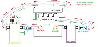

What is a better option. I thought running one catch can vta with the perm pcv plate and one occ non vta was the best setup previously. I now see people running one catch can and one breather cap on their valve cover.
Does the simple 1 occ and breather cap system solve the excessive crankcase pressures?
This is the setup I thought was to be the best solution:
Any help or info clarifying will be greatly appreciated.

Ya I think ima run it like my diagram I originally posted to see how it does just picked up another occ vented for this one so I'll have one of each and I should have everything now just need a perm plate.

Yep, I've run many different setups from single can, single can + slash cut pipe, dual pcv plate, etc etc and I this setup has been the best on every car I've seen.
You keep the stock PCV system in tact and add enough venting under boost for anyone on earth.
You just route the breather and your second VC port to your vented can. I should have a pic somewhere.

Ya a pic would help of the valve cover how it's setup with the lines.... What did u mount the second occ to?

 Old 07-03-2015, 01:57 AM   #25
MSP611's Avatar
Location: layton, UT
Posts: 2,291   (View Stats)
Thanks: 122
Well one is for cleaning Ur intake mostly and the other in the current setup we are talking about is for venting CC pressures.
In progress:
Voltwings (07-03-2015)

Thanks: 7
Thanked 23 Times in 20 Posts
So basically you use a second CC instead of a breather filter just to not have the filter get coated in oil? But either way aren't fuel trims thrown off like stated above?

 Old 07-03-2015, 02:28 AM   #27
MSP611's Avatar
Thanks: 122
U use a second vented CC with lines coming from the vent on the valve cover and a custom welded AN fitting or ur choice of fitting to the other side of the CC.. As for the Fuel Trims it is very minimal amount... As for the filter I have no experience with it
(only have experience with a venturi setup) and the point of this setup is for future headroom if wanted and proven success on BT applications.
In progress:
