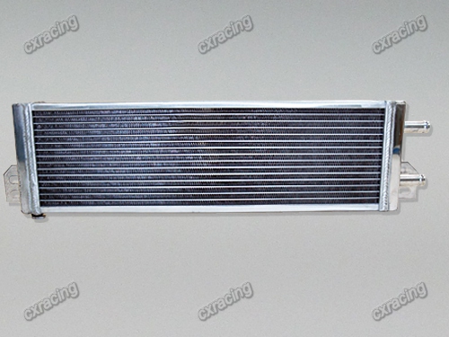

I have a liquid to air intercooler that is built and can be easily reproduced.
Liquid to Air Intercooler
4DRHTRD is offline   Reply With Quote
 Old 04-15-2008, 01:47 PM   #19
Bravnik's Avatar
Posts: 383   (View Stats)
Bravnik has a reputation beyond reputeBravnik has a reputation beyond reputeBravnik has a reputation beyond reputeBravnik has a reputation beyond reputeBravnik has a reputation beyond reputeBravnik has a reputation beyond reputeBravnik has a reputation beyond reputeBravnik has a reputation beyond reputeBravnik has a reputation beyond reputeBravnik has a reputation beyond reputeBravnik has a reputation beyond repute
Thanks: 9
Thanked 96 Times in 48 Posts
Groaned at 33 Times in 22 Posts
Now that's hot. How much to reproduce?
Ah followed the link. $1800 is a bit much. I can get a FMIC and DP for that
Looks really bad ass though. Good work.

Yeah unfortunately it's a liquid to air core using the factory end tanks and a front heat exchanger as well as a pump. The core is good for up to 600WHP and easily upgradeable past that with a higher output pump. Due to all the pieces it's much more expensive to produce, the core alone is around $600 cost...

Not going to be able to make a cheap setup of that, if you do the core will only handle 200 or 300 WHP which would be a waste.

I would say good luck with that. The key for me was to have a core that would fit using the factory end tanks for ease of installation and as factory look as possible. We accomplished my goal. I don't believe in doing anything "cheaply" as it'll bite you in the ass in the long run. A leaky air to air core is no big deal, a leaky water to air core = water in the motor and insta-boom!!! Good luck getting an Ebay company that sold you the core to cover the $10K plus for a new engine.
