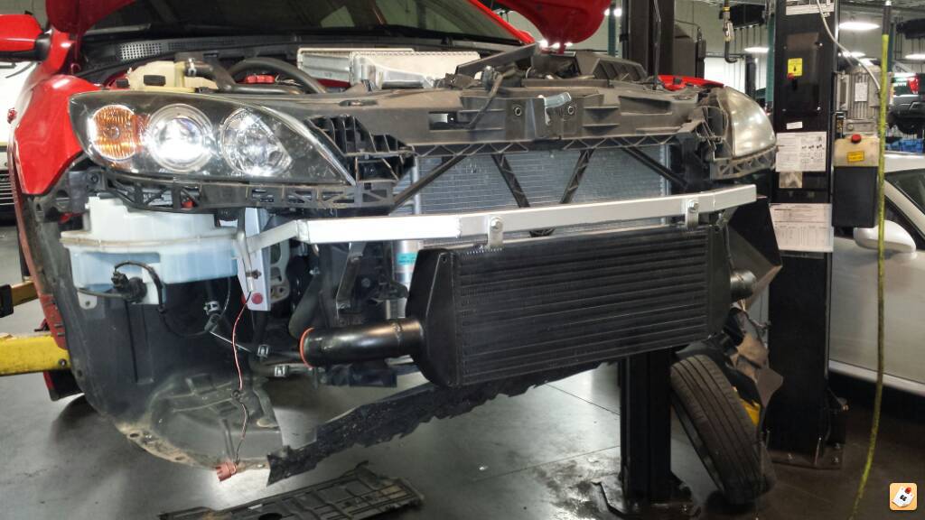

Came in this afternoon and spent a few hours this evening putting it in.
Overall the design is nearly flawless. No cutting or trimming to speak of, just a few simple changes like moving the outside temp sensor.
Removing the stock crash bar was honestly the most annoying part.
Anyways, core is gorgeous, nice big Garrett core, everything is hand welded and very well put together.
Comes with COLOR instructions, and all the nessessary bolts. Their crash bar bolts up into the stock holes, and positions the intercooler perfectly.
I notice little to no lag from the ETS top mount to this, and its crazy how fast the Intake temps drop while moving in comparison to the top mount.
Pics (cell phone sorry, lens on my nikon is effed )

Looks great! I haven't done much reading into FMIC, so excuse my ignorance, but what happens if you get front end damage? Will the air bags perform under the same expectations as a stock Speed3 with OEM crash bar?

Any logs/data from this FMIC? Also, how does the butt dyno compare to the ETC TMIC?

Website displayed price, and that that you receive when you call john @ UR are very different. I wont go into details, but it was much cheaper.
Butt dyno while still running a tune LEX dialed in for a top mount is the same, except low end torque is more noticable.
As for logs, once LEX sends me a tune off the logs i sent him for it, ill post the progress.

The garret cores typically have a high fin density but that one looks lower than usual which is a good thing for low boost and high flow.
Did you take any pics of the IC installed on the crashbar with the bumper off?
