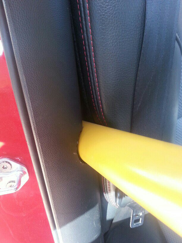

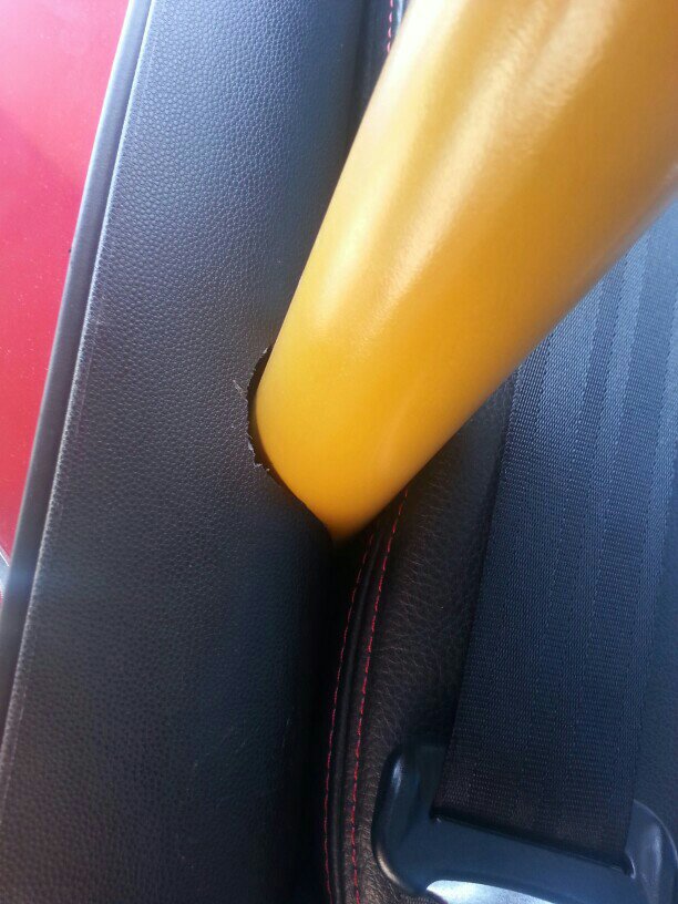

Here's a couple pics with the 4pt harnesses. And no I dont let anyone ride in the back. Its just for appearances and noise dampening.

Nice harness bar BTW @S-hendrix. Could you share more pics of the harness bar where it's attached to the chassis?
1) - Where did you get it from?
2) - who is the manifacturer?
3) - How does it attach to the chassis where the rear passenger put their feeds and in the trunc?

Its the Autopower roll race bar. It's a bolt in half cage. It has another cross bar that goes diagonal across the hoop. I need to paint it since I recieved it seperately. The company is pretty awesome because the cross bar I recieved was smashed by a forklift (somehow.. this metal is heavy as hell) during shipping. I signed for it without inspecting like a moron. I called Autopower and he said mail back the damaged bar and he would make me a new one. The only reason I had to mail it back was so he could lineup the holes from the other bar. I recieved it a week and a half later and fitment was perfect.
Install was kinda tough. Def a 2 man job. To attach it you drill holes in the floorboard and use the provided sandwich plate to snug up the bolts. You have to cut the plastics a little. The floorboard in the backseat is the same way. It was pretty straightforward because once you get it in everything lines right up. It mounts pretty much only one way and there is very little room for error.
I bought this setup off of vivid racing and they took like $75 off the price if you call them and ask them to do better on the price. Freight was like $150 if I remember correctly.

If you're ever going to drive on the street, uninstall the harness bar and 4-point (shudder) and use your stock belt. The damage that can be caused to your neck/back with a harness bar and no cage in an accident is terrifying. The top will cave in on you and you have nowhere to go like you would with a regular (folding) seat. I'm sure you've read up on all of this, but to re-emphasize for anybody considering this... harness bar + no rollover cage + harness + street driving (track accidents apply too) = a SERIOUS no go.
Also, 4-point is very dangerous in its own right. Always save up for the 5/6 point to eliminate the risk of sliding under the lap belt in case of an accident resulting in the sudden reduction of motion.
