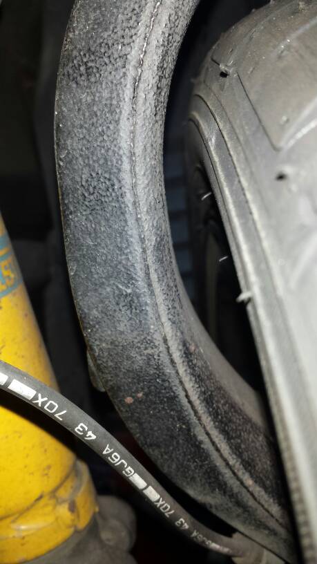

That knuckle clearance is good news, I thought we had to go with 5mm closer max, but your setup is 15mm closer.
Here's clearance off the knuckle.

Sumitomo's definitely run small which is why that 265/35 barely bulges on your 8.5", I ran 265 595 RS-R's on a 18x9" +38 wheel on my Gen1 and they bulge

The Sumitomo is basically a slightly taller 255/35. It runs about .25" narrower than others. That was a part of my research stuff for the fit. I compared a lot of tires, but what I remember is that BFGs run stupid wide. They are like .25" in the other direction.
