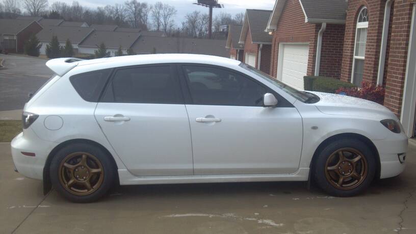

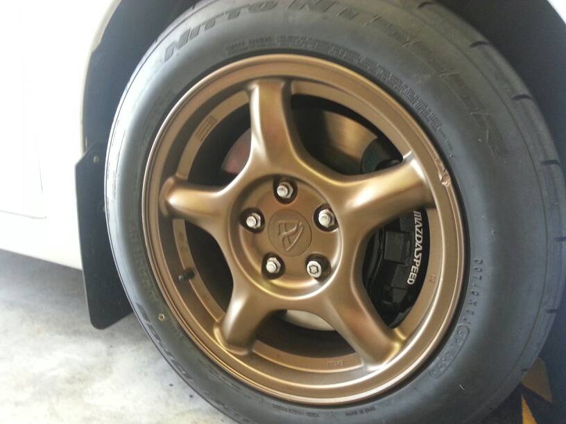

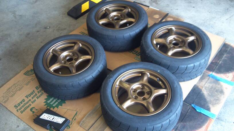

I'm running 245/45/17 NT 555R's on evo 8 wheels. 17x8 +38 no spacers and no rubbing. 38psi in the tires. I'm sure if I ran 20psi I wouldn't spin at all. I'm pushing about 330-340whp 375-390wtq
Can get more pics if anyone wants.

Have you launched with those? From what I've seen, only thing that can stick on a launchare slicks

If I lowered the the tire pressure they will hook

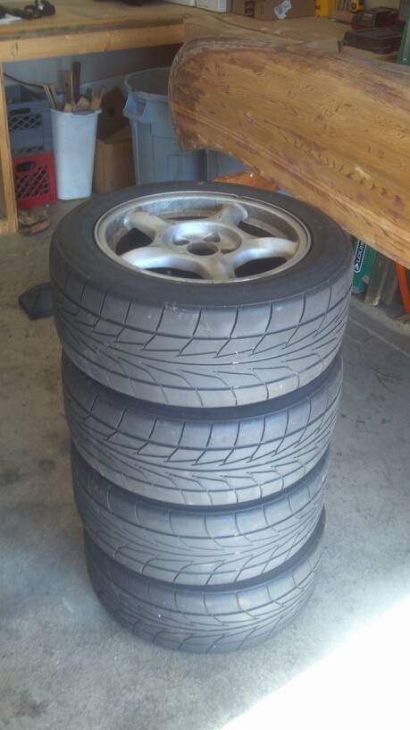

I run 225/50/16 nitto 555r drag radials.
Straight line traction is amazing. 2nd and 3rd are useful again! I don't take the car to the strip so there's no use for slicks on my setup.
I even managed to keep up with the faster nator guys on the dragon. Overall I've been really happy with the tires.
I got them already mounted on FDs for under 400. They came with Efini center caps too
