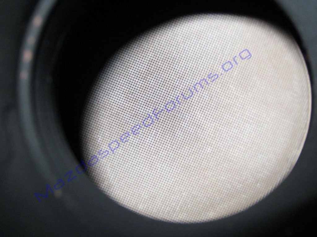

Stock converters internals.. notice the honey comb screen

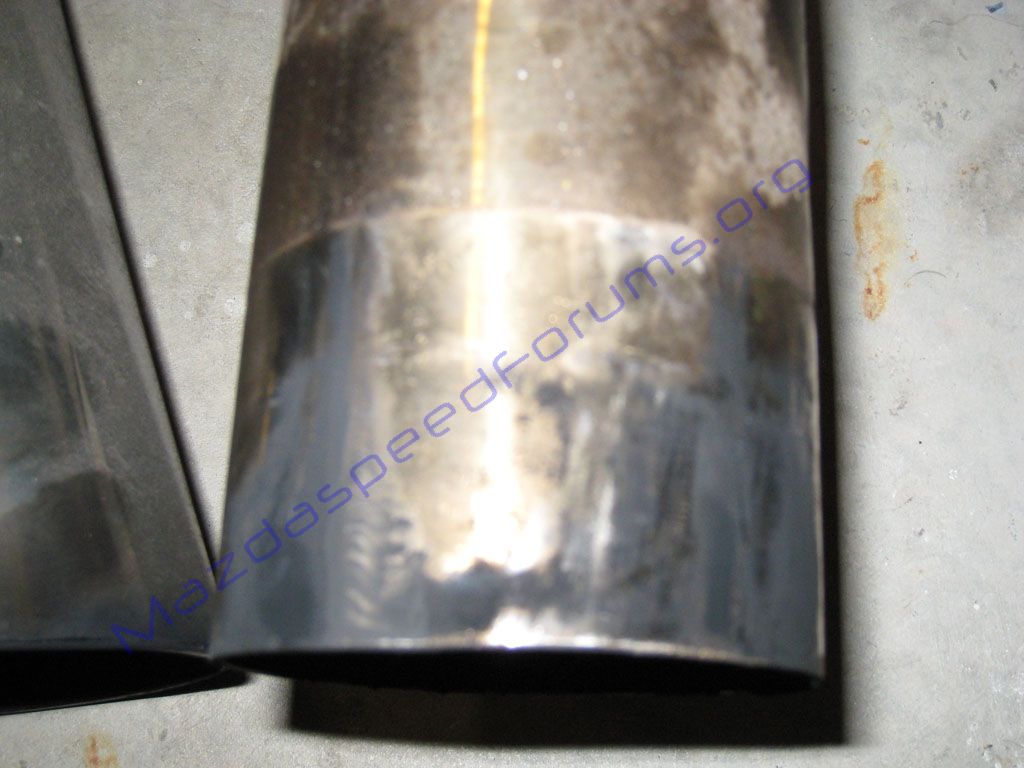

Here is a picture of the slip joint and black carbon all over them

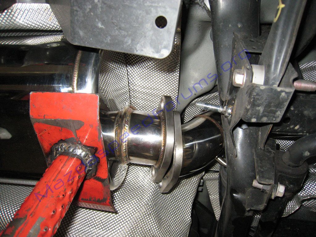

Here we are lining up the first section of the catback forward piece
http://www.mazdaspeedforum.org/forum/pics...cobb_cbe/8.jpg
