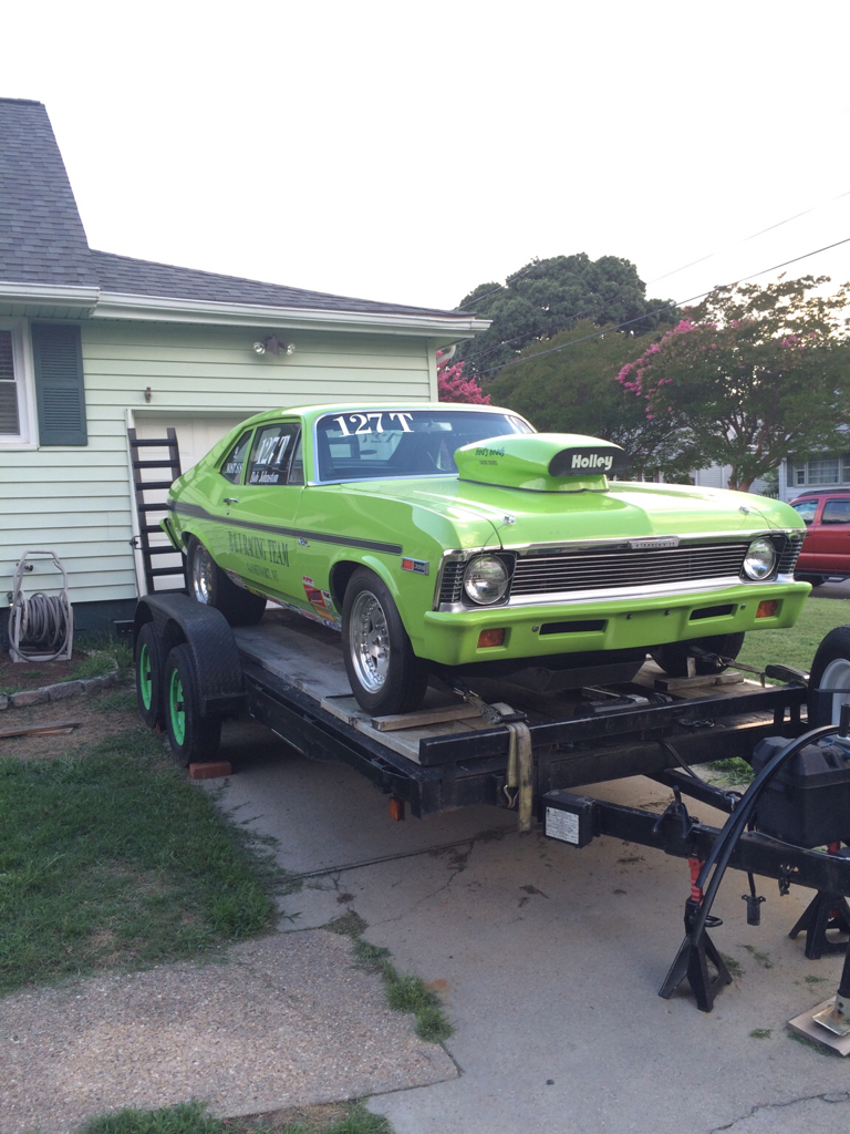

BobtailedSnail's LSx MS6 and N/T Nova Decided to resurrect my account a few weeks back. Some of you know who I am. Not quite OG, but not a Noob. Trip down memory lane: Learned a ton from this place when I first got my MS6 about 6 years ago. I built my first top mount kit from what I learned here. http://uploads.tapatalk-cdn.com/2016...0b4a95cf27.jpgA few years back I got the idea of doing a compound turbo build on the 6, ended scraping that idea. Turbo tech was advancing and undermined the purpose of the build. Ended up building the motor, doing a HX40 top mount setup, PI, etc.http://uploads.tapatalk-cdn.com/2016...cddb497494.jpg I lost interest and never got the car's tuned finished. I began parting the car out with what I considered a brilliant idea. In the mean time: I acquired a 69 Chevy Nova than had been sitting on a trailer for 3 years after the owner passed away, raced it one season then broke it down and changed the setup.http://uploads.tapatalk-cdn.com/2016...10e0897cc4.jpg Put new slicks on it http://uploads.tapatalk-cdn.com/2016...a6dd92189f.jpg She ran a best of 9.77, all I did was change the oil in the motor. Lol. 468BBC with a glide Pulled the motor and trans and sold it off http://uploads.tapatalk-cdn.com/2016...ff2acadb92.jpg Acquired a new motor on CL and after a few weeks a decision was made to go Twin turbo. Sent the car to 16W Fabworks and Anthony knocked it out of the park on the turbo mounting and intercooler. http://uploads.tapatalk-cdn.com/2016...a69c88dcde.jpg Got rid of the old school rake and slapped some radials on it. http://uploads.tapatalk-cdn.com/2016...5189614932.jpg The car's name is The Soul Shaker. It's a N/T car so don't ask what it runs lol. On to the mazda's current state. Used a small block I had in the shop since that and the LS are similar lengths. http://uploads.tapatalk-cdn.com/2016...f2c47c37cb.jpghttp://uploads.tapatalk-cdn.com/2016...52b1befaa6.jpghttp://uploads.tapatalk-cdn.com/2016...28b35f7c60.jpghttp://uploads.tapatalk-cdn.com/2016...26b647affd.jpg |

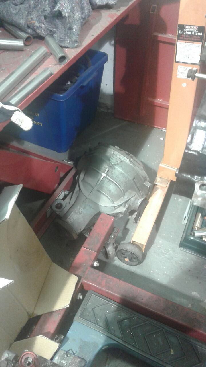

Ran up to Lancaster today to pick up a subframe and shot over to 16W so Anthony can work his magic on some mounts and a cover. He's got his work cut out for him. What seems to be a major weakness in the Cobra IRS is the rear cover mounting point, Anthony is gonna address that and maybe we can get a mounting solution figured out for others that want to do the swap. http://uploads.tapatalk-cdn.com/2017...203fdedf92.jpghttp://uploads.tapatalk-cdn.com/2017...f2cd508659.jpghttp://uploads.tapatalk-cdn.com/2017...c23833616d.jpg I just plopped the subframe on the rear to get an idea of the size difference. http://uploads.tapatalk-cdn.com/2017...0770535621.jpg Now I've talked to a few interested in the swap and those who don't exactly have the same power goals as mine. I will try to see if it's a viable option to maybe utilize the stock rear by eliminating the viscous coupler in the snout. It's a consideration, not a promise. The factory rear is small and I don't know what kinda of torque it can take as a single unit. |

Quote:
Yeah I new for even my SBE(stock bottom end) power goals the factory diff wouldn't hold up. Especially on a trans brake. I figured if a speed 6 was making 1000wtq the most the rear would see is 500wtq and that's your average cammed V8 lol so who knows what borrowed time it would be on. I thought about buying the whole cobra subframe just to see if it would come remotely close to fitting but $1300 could be spent else where at the moment. If I happen to come across one closer to me I'll measure it up. |

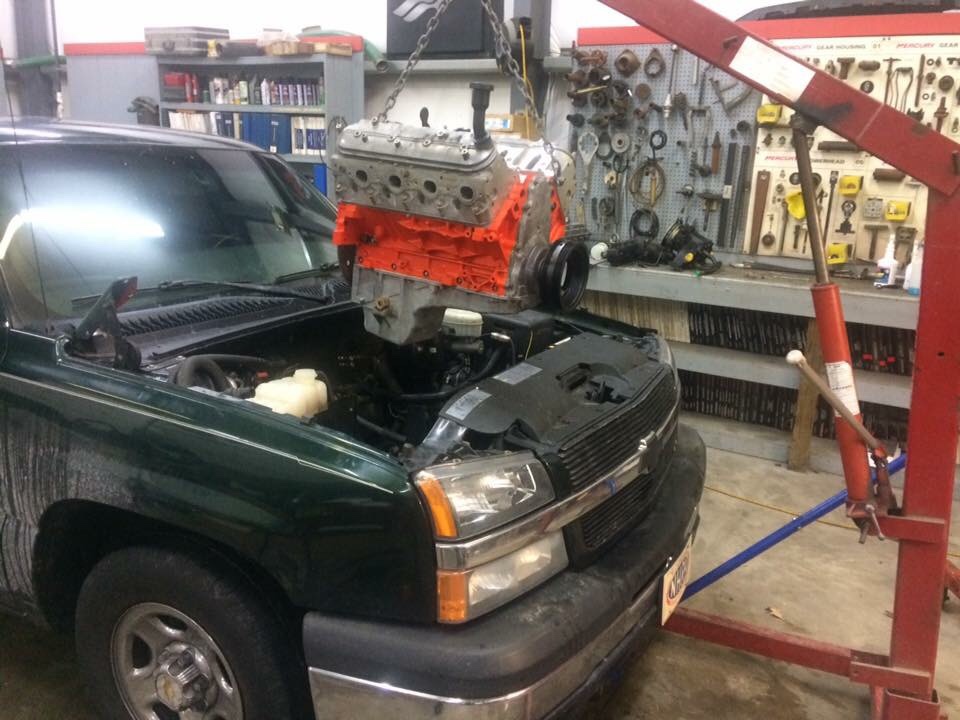

Aye!!! My motor finally got pulled from the truck. http://uploads.tapatalk-cdn.com/2017...9341190c41.jpg And his new one got put in http://uploads.tapatalk-cdn.com/2017...2e80883d1d.jpg |

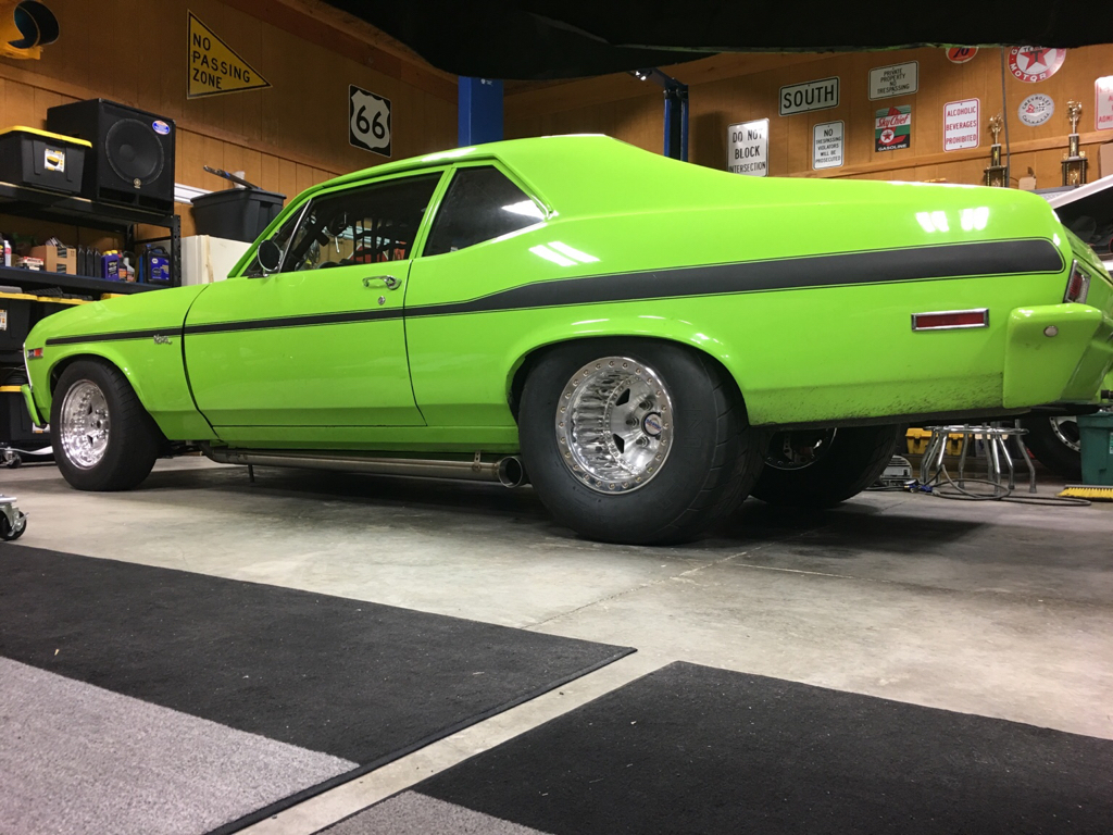

Looking good man, this is cool. That nova is gorgeous |
Quote:
Thank you. The paint is a little wild. I think the color is called Sublime. It's a Mopar color. Hopefully it performs as well as it looks. |
