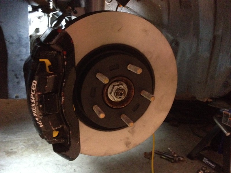

So I've still been chipping away with the MS3 and ran a couple events at the end of 2013 before heading into the off-season. During the winter months the only real upgrades were a new set of stock rotors with some EBC YellowStuff brake pads...
photo 1 by Sir Turd Ferguson, on Flickr
photo 2 by Sir Turd Ferguson, on Flickr
Other than the new brakes the car was unchanged from 2013 with the following suspension set-up heading into the first few events of the 2014 season...

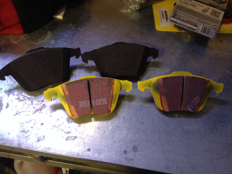

The changes to the brakes did help with some improvement in initial bite and braking power...but I wouldn't call it a night-and-day difference since the stock brake pads are pretty good IMO for this car. Overall the car balance felt like I had remembered with a neutral entry and mid-corner that leads to exit U/S while trying to get on the power. This course also featured some tighter sections that worked against the MS3. For tires I'm still running on the first set of BFG Rivals I had purchased with the grip level holding pretty consistent as they wear...after running on R-comps for so many seasons since the beginning I have enjoyed the change to street tires as I can now focus on improving my driving line through the course vs. having to manage the grip level (especially when running the 285 front R1-S tires) at the same time.

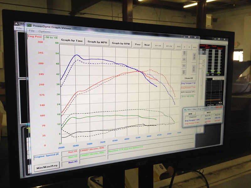

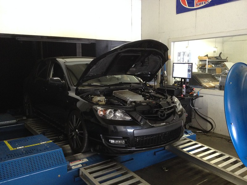

Before running at the upcoming SCCA Match Tour in Atlanta I dropped the car off at 42 Autosports in Concord, NC to have some much needed valve cleaning completed (car is currently at 56k miles and this will be the first cleaning) along with some engine tuning on their Mustang dyno. I was really happy with the work they did and got to hang out in the morning while the tuning was completed to check out the process. This shop works mainly with Subraru's but has tuned some MS3's before using the COBB AP. My final STX-legal map (solid line on first chart) is below along with an updated Stage2 map (second chart) for driving around on the street. The biggest limitation with the STX map is the stock boost limits which resulted in a pretty big drop around 5000rpm...
photo(2) by Sir Turd Ferguson, on Flickr
photo 3 by Sir Turd Ferguson, on Flickr
photo 2(1) by Sir Turd Ferguson, on Flickr
Other than the engine tuning & maintenance I had ordered a new set of control arms and swapped out the stock bushings for the TopSpeed bushings that had been in the garage for a while. The Atlanta Match Tour would be my first chance to check them out.

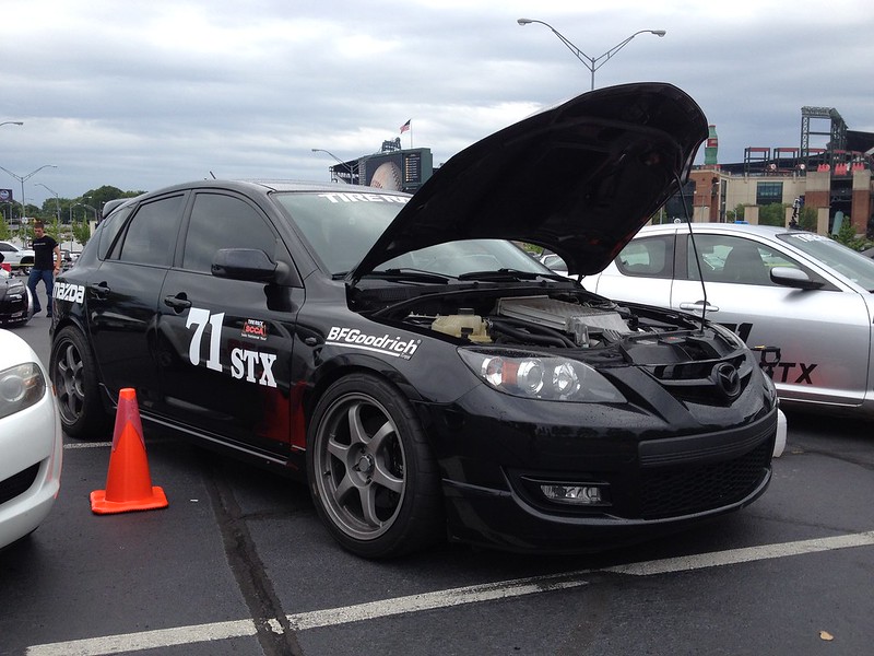

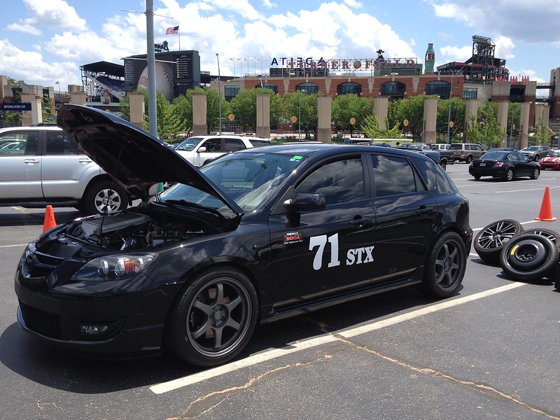

SCCA National Match Tour - Turner Field, Atlanta
This would be my first event at Turner Field where the Atlanta Region runs the majority of their schedule...I have ran with them in the past but always at Atlanta Motor Speedway. I drove down early Friday morning to get some runs on their test & tune course which is a sealed asphalt lot similar to Z-Max in Charlotte.
photo 4 by Sir Turd Ferguson, on Flickr
The car set-up had not been changed since the LPG event with things standing as follows...
Front Camber = ~-2.9
Rear Camber = ~-0.5
Front Toe = 1/8" Out
Rear Toe = 1/16" Out
Spring Rate = 800F / 800R
FSB = Disconnected
RSB = Hotchkis Full Stiff
Tires = BFG Rivals w/ ~10 Events & 50 or so runs
Pressures = 37F / 55R
During the test runs the car was pretty limited by a lack of front grip & flat-sliding through mid-corner to exit. The course surface was sealed and very smooth so it felt like there wasn't any roughness to generate enough front grip plus the lot was pretty bumpy and with the higher spring rates the car was a hand full to drive. There was an RX-8 in STX that has trophied at Nationals before and they were about 0.5 seconds faster on the 35 second course, so overnight I decided to change the 800lb rear springs out for the 900lb in an attempt to get some more rotation through the corners.

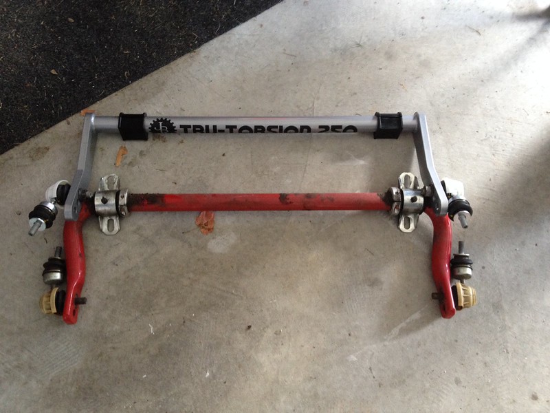

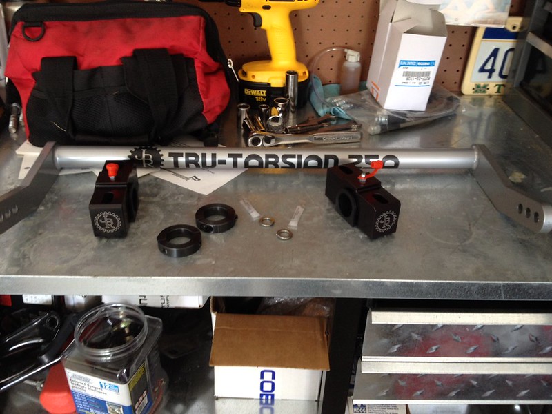

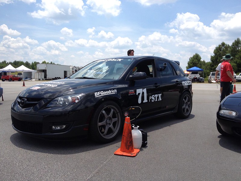

Last week the new James Barone Competition RSB arrived and was installed on Saturday before taking part in the Central Carolinas/South Carolina AutoX at the Michelin Proving Grounds on Sunday. The bar has a nice quality of build and I was wanting to try the different design vs. the Hotchkis in an attempt to get a stiffer bar and more rotation. I also ordered some new stock end-links to add onto the install. Compared to the Hotchkis the bar does feel heavier and came with some pretty beefy mounting brackets...
With the new RSB installed I was ready for the next event on Sunday. The rest of the car remained unchanged with the spring rates staying at 800F / 900R and starting cold pressures of 38F / 48R.

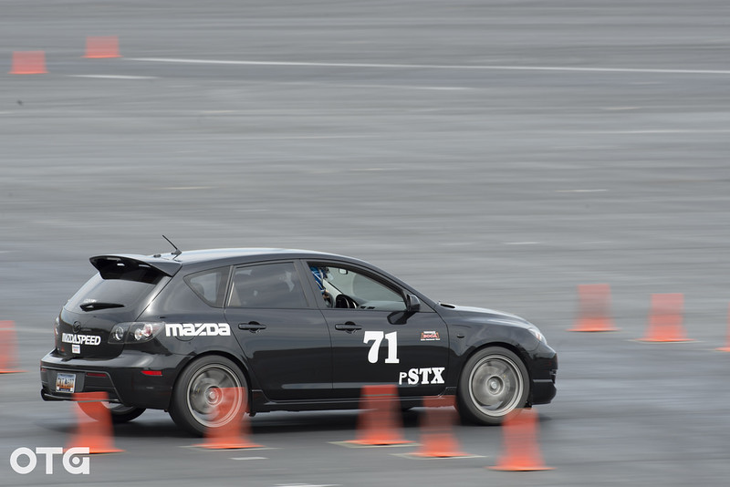

SCCA Central Carolinas AutoX #4 - Michelin Proving Grounds
Compared to the Hotchkis the new RSB did feel stiffer and resulted in better rotation and quicker steering reaction (the car felt more "pointy" when driving around on the street). My results were some of the best I've had against this level of competition and I was the fastest STX car (beating the RX-8 that won the Atlanta Match Tour by a tenth). The high speed balance of the car was really good with only some low speed U/S holding the car up on the tighter corners...I think a lot of this could be fixed with an improved LSD so I could get on the throttle earlier in these tight corners with the car continuing to corner instead of pushing out on exit. This will be the big project for this fall/winter.
There were some timing issues at the event and I was the beneficiary of a couple re-runs. This allowed me to land my last run that was ~two-tenths faster than my best time if limited to the standard four runs without the re-runs due to timing errors. I also had a first in my years of autocrossing...the four-point harness got caught up in my seat recline handle on my 2nd run, so as soon as I hit the gas to leave the starting line the seat reclined all the way back and I was just left holding myself up with the steering wheel. That was fun.
The weather was pretty hot on Sunday (low 90's) so I sprayed the front tires & intercooler between each run and continued to bleed the front pressures down to 37-38 psi while allowing the rear pressures to climb. These are the same Rivals I have been using since starting STX more than a year ago and they have held up pretty well after ~15 events.
I also just bought a GoPro camera so I can start recording some runs. This was my first attempt at using it and my best run from the day is below...I'm pretty impressed with the quality of video and how easy/user friendly the camera is for set-up + the wireless capabilities. Wish I had gotten this camera sooner.
Results
PAX: 9 / 156
STX: 1 / 13
PRO: 9 / 27
