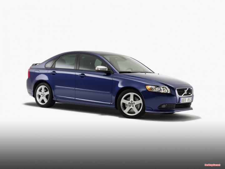

Boother 10-10-2008 09:47 AM
The turbo awd version of the S40 100% uses the same caliper as the MS3. I have seen the cars side-by-side and they are identical. The other versions of the S40 use the same front caliper as the regular Mazda 3.
This one has the MS3 caliper.
http://www.desktopcar.net/wallpaper/...vo_S40_267.jpg

speed3 10-13-2008 10:16 PM
They should of said the R model. Is like comparing the brakes on a s60 and s60R.
Boother 10-14-2008 08:03 AM
There is no R model for the S40.
speed3 10-14-2008 07:05 PM
Quote:
well they should of said the awd model. I'm done here, lol

So, to clarify (regarding the MS3):
The MS3 uses the same calipers/rotor size as the Volvo S40 T5 AWD (NOT the S60, and NOT the XC90 - the XC90 appears to use the same caliper as the MS3, but the rotor size is 316 mm instead of the MS3's size of 320 mm).
